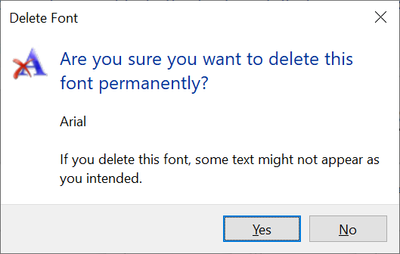

I think we are on the right track. I have found small fonts regular in the fonts folder but if I try deleting it I see the following popup:

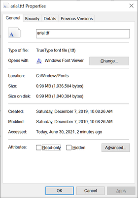

The properties shows:
For me this suggests that Arial.ttf is installed under the name of Small fonts regular. I dont even know if this is possible, but for sure I can't delete / uninstall this font as windows says its a protected system font.

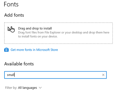

Another thing that I have found is that if I open the font settings and type "small" than it returns nothing. (but if I type eg. Arial then it show that).

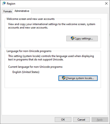

Finally I got it... it was a localization thing. In the control panel > region > Administrative > Language for non Unicode programs must be set to English. I'm unsure if the previous steps (eg: reinstalling small fonts, reinstalling MS office etc) have done anything. Could be a combination of everything, but if you read this topic the first time then try changing this fist.
Man... this was a hard one to figure out 😛

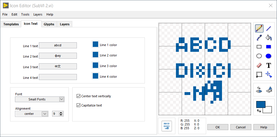

The icon editor doesn't work well with unicode, not for small font.  I can't use Russian or Chinese.  But no blur.
