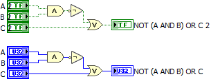

Fortunately, in LabVIEW there is even a way to graphically solve any Boolean expression without having to write any text. 😄 Try it instead!
And no, the formula node will not work with boolean datatypes (green wires). It will do bitwise operations on integers of the same datatype, same as graphical code. Make sure you deal with operation precedence correctly.
You will only be able to do the blue code using a formula node.
