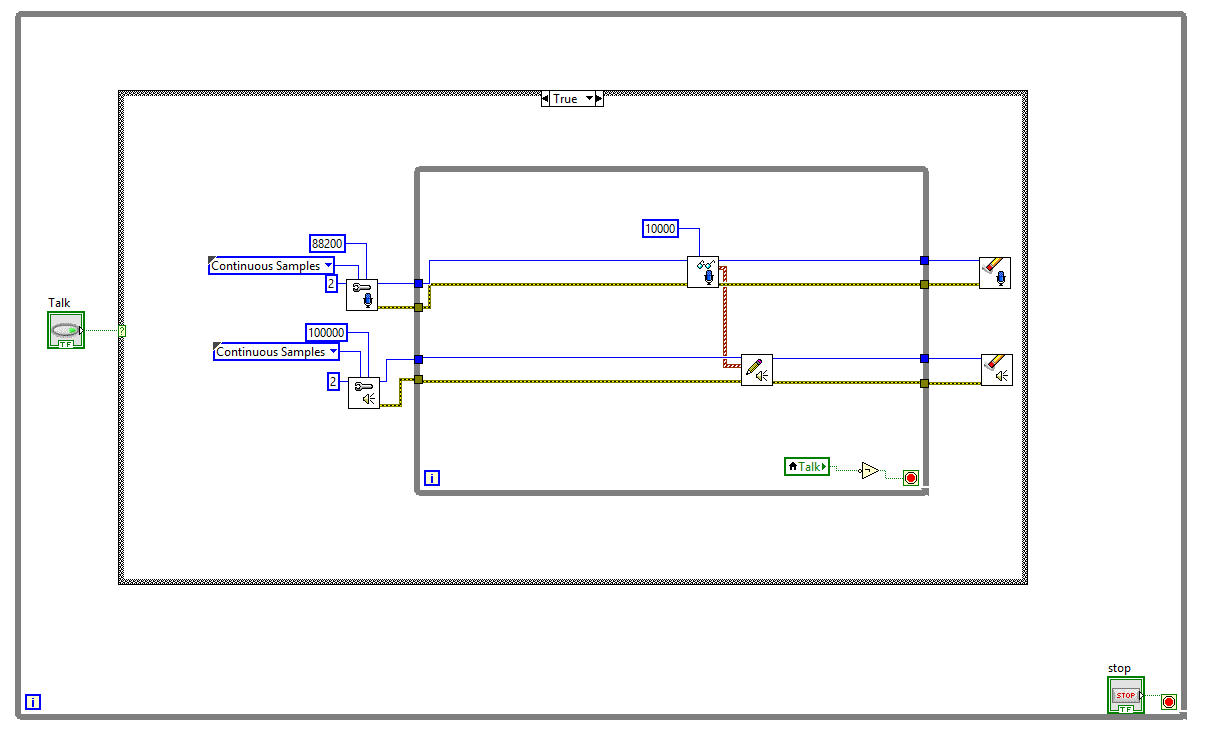

Hi there,
This is basically the VI with which I want to move the Talk and Stop controls from this VI to the others Front Panel.
Hope it helps and let me know if not. Thanks
No this is just a picture. Where are the actual VIs?

@Treesus wrote:
The current setup has two VIs called from the VI server with their respective Front Panels opened. One of the front panels is literally just a boolean control push button that controls a case structure (so how the VI behaves essentially). I want to combine the two front panels so that this boolean control is in the same front panel as the other one. I could use a global to move all the controls indicators from both VIs into one front panel but feel like that is over the top. I thought there must be something simpler that whenever this push button is pressed it would change case of the other VI.
To reiterate my previous comments, you need to give us the full information in order for us to try to solve the problem. You need to attach simplified version of all code (caller, subVIs, etc.)
  • What is "called from the VI server"? Please define what you mean by that! What is calling what, how, and in what order?
  • If you say the other VI "literally contains only a button on the front panel", we would also need to know what's on the diagram. Is that button value polled in some way? How often? There has to be other functionality, e.g. how does that VI stop?
  • So far you showed us an incomplete(!) picture of a small part of the code, and it immediately tells us that you are very new to LabVIEW, because it is full of typical beginner mistakes (What is in the other case? What is the CPU use when "talk" is false? What determines the loop rate? Why is there a stack of two while loops? Why is there a "not" going to the inner loop termination instead of just changing the termination condition? All you need is a proper state machine (look it up!) with one loop total and a case structure. No local variables needed.
My advice would be to ...
  1. first start learning about proper code architecture, do all avaiable tutorials, look at the shipping examples and templates, etc.
  2. Attach ALL Vis (or simplified versions that still show the issue), tell us exactly how things are called and how you run it all.
Message 6 of 10
