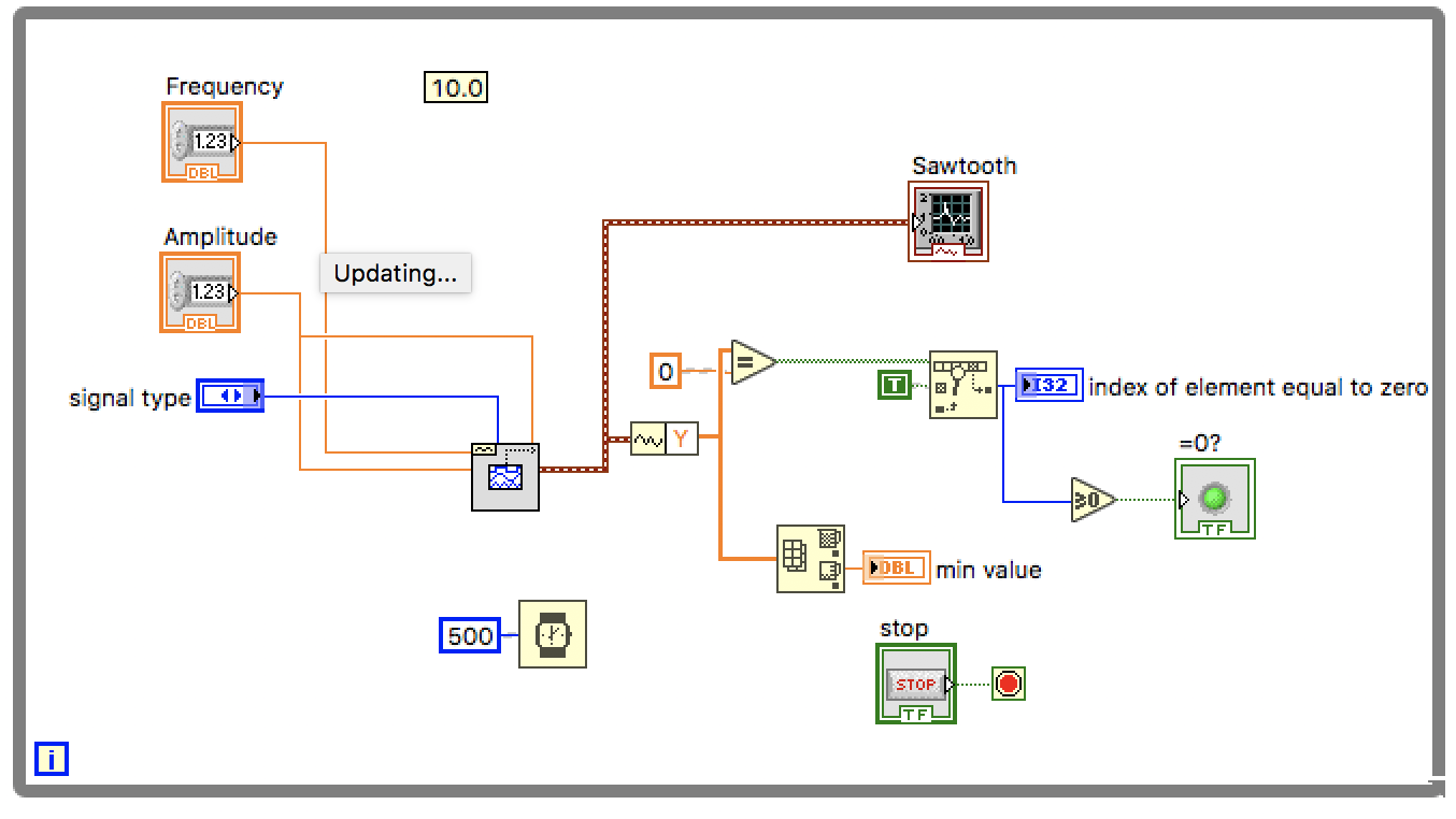

Sorry about that,
The original VI is not with me at the moment. However, I am attaching a simple VI that represents the corresponding part in the main VI. This should contain the scope of the problem.

The evil Dynamic Data Type (DDT) strikes again! The output of the Express VI which generates the simulated signal is Dynamic Data Type. This obscures the structure of the underlying data. The conversion you chose was to a single scalar. The simulated signal contains 100 samples. Which one does the conversion select? The first, I think, or maybe, the last. It does not tell you. But what are the chances that the one of one hundred which you compare was actually the one you wanted? You really want to compare all of them.
Rather than use the Express VI with all its problems, I prefer to use something like Basic Function Generator.vi from the Signal Processing >> Waveform Generation palette. Its output is the Waveform data type, which is a cluster of an array of doubles Y, dt = the sampling interval, and t0 = the start time.
I extract the array of samples and compare all of them to zero. Then search the boolean array for a True value.
Note also that for non-integer values of frequency the minimum value in the Y array may not be zero even though the amplitude and offset are the same.

Thanks for your example, johnsold. It was a good base to solve this task from.
