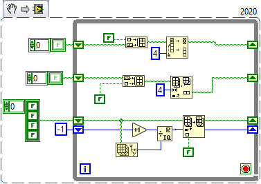

Use a shift register.
Either rotate a pre-sized Boolean array, or simply use build array and split string (or delete from array) to keep the array 4 elements.
There are so many ways to do this, it's scary.
The min max is a bit  obscure, but a good compact way to check if all values are the same.

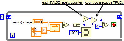

Here's one possible way to stop a loop if the input is equal for 4 consecutive iterations.
You haven't really explained in detail how the file(s) are written, updated and read. Is each image in a new file? Is each image appended to an existing file? Does it overwrite the current file? If the file contains just the last image, there is no need to parse it into value. Just compare the entire file as a string. Maybe you could just read the modification time of the file? So many possibilities!

@Ghost_79 wrote:
So what I'm looking for is for LabVIEW to consider the most recent 4 loops temperature measurement values (floats) and confirm all four are not equal. If so, generate a true. Else false.
My code will stop the loop if four consecutive values are identical. You can substitute any datatype for the "value", which is a 2D array in the picture (scalar float, string, integer, whatever.). The feedback node gives the value from the previous iteration, which is compared with the new value. You can probably use the string directly, no need to scan it into a float.

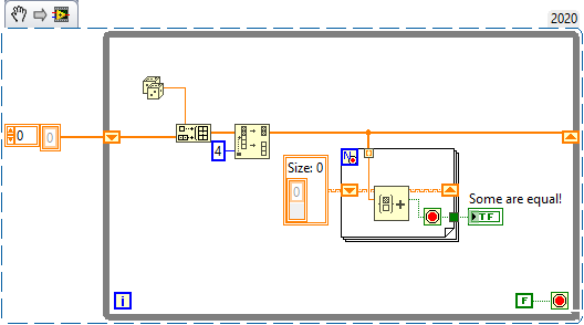

To check if all four are not equal you'll have to keep a buffer of all 4 values.
That's basically what I posted, only you'd have to keep the values, not the Booleans.
You can use a set to check if all 4 values are different:
Note that you're comparing floats, which is generally a bad idea. Those floats better be quantized in some way, because 1.2 doesn't always equal 1.2.  See for instance equality - What's wrong with using == to compare floats in Java? - Stack Overflow or Comparing Floating-Point Numbers Is Tricky (bitbashing.io). It's the same problem for Java, C++, C# and LabVIEW...

This is actually an incorrect algorithm for the given problem. All you need to see is if the value has not changed in the last four updates. For that it is sufficient to compare each new value with the previous as I have done.
For example if the last five values are A-B-C-B-A, they have been correctly updated four times, once with each iteration, even though some of the values are the same.
I would still recommend an out-of-band monitoring of the instrument connection, depending on the noise and bit resolution of the signal and formatting, values can be the same even if there was an update.
You are good comparing floating point numbers because if the value does not update, it will be binary identical. But in the general case, listen to Wiebe. Remember that I said to compare the string instead (avoiding the expensive scanning!). Faster and safer!
