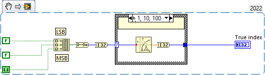

or this one if you're feeling mathy:

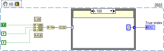

Here's a simple implementation, but it doesn't catch the error condition where more than one Boolean is True:
There's lot's of ways your code can find which Boolean is True. Which way makes the most sense to you?

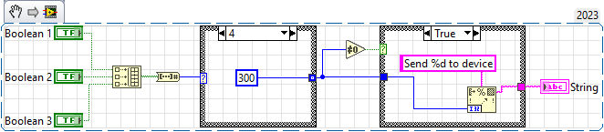

How about something like this?
  1. When only Boolean 1 is True send 100
  2. When only Boolean 2 is True send 200
  3. When only Boolean 3 is True send 300
  4. All other Boolean combinations send nothing

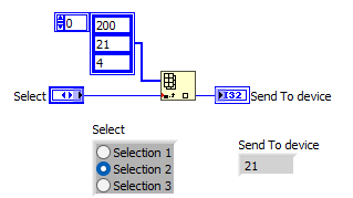

If only exactly one boolean must be true, I recommend to use a radio button instead.
