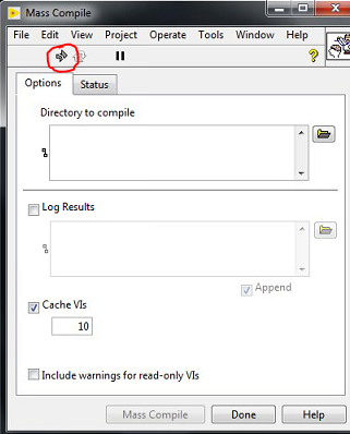

Broken arrow on mass compile from advanced tools
The mass compile tool at Tools->Advanced->Mass Compile... has a broken arrow.
Any thoughts on how to fix? (using 18.0.1f1 64-bit on windows)

Can you click on the broken arrow to have it bring up the "Error list" window or does that not work?
Message 3 of 10
(4,695 Views)
I can click on the broken arrow, but the resulting dialog says "No VIs with errors".

I also have LV2013 32-bit on the computer.
It may be an artifact of my uninstalling the VI Package Manager. (I really don't want that, since the factory computers I deploy to have no internet connection, and I can imagine what all of the dependencies having different versions might do).
I'm going to uninstall and reinstall LV and see what that does ...

I reinstalled all NI products on 2 stations, this time deselecting the package manager in the LV installer. The arrow in mass compile tool arrow broke after I mass compiled a directory of VIs I have. So now I can't blame it on the VI package manager.
Message 8 of 10
(4,657 Views)
"Tools»Advanced»Clear Compiled Object Cache" fixed the issue.
Message 9 of 10
(4,608 Views)
Scratch that, I thought it fixed the issue but apparently not ...
