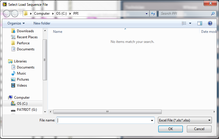

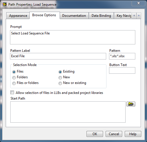

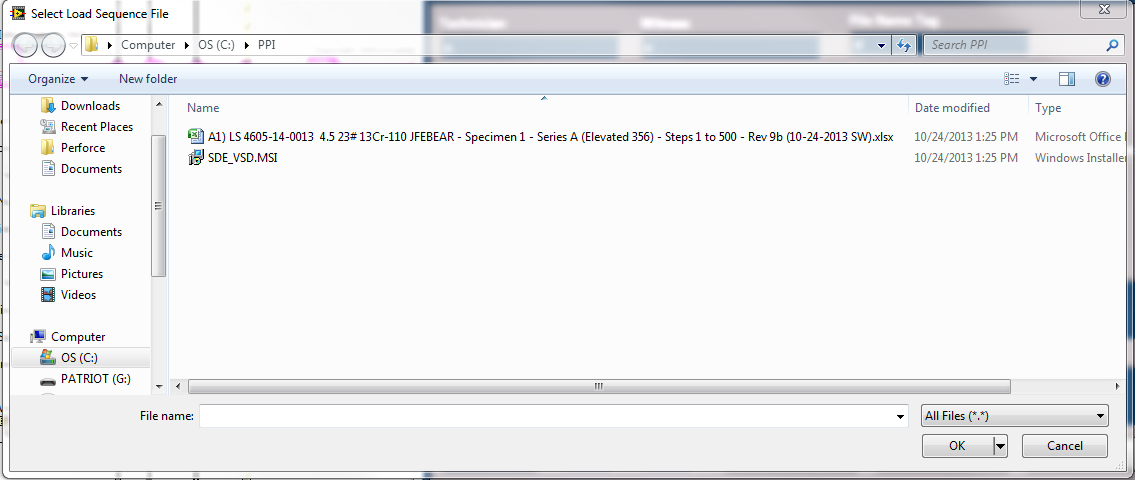

Selecting the multiple Pattern: *.xls:*.xlsx below from Path Properties does not produce the required files I am looking for, can someone point me in the right direction?  As you can see from the attached, Only selecting 'All Files (".") delivers the result I am looking for.  I have already pursued the following link with the same results. http://forums.ni.com/t5/LabVIEW/Add-multiple-selections-for-pattern-label-in-file-path-control/m-p/2....  I have also tried using the File Dialog Express.vi and Open/Create/Replace File.vi.

Using a semicolon instead of a colon works for me.
(3,308 Views)
Thank you Sir!  That did it! 🙂
