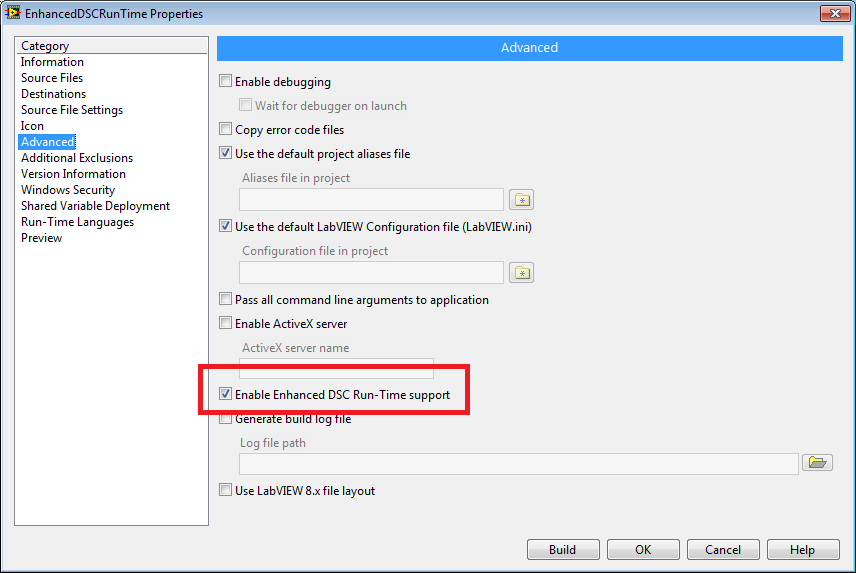

Standard Run Time: Enable Enhanced DSC Run-Time support unchecked
Enhanced DSC Run Time: Enable Enhanced DSC Run-Time support checked
As per the following Build Spec Setting:

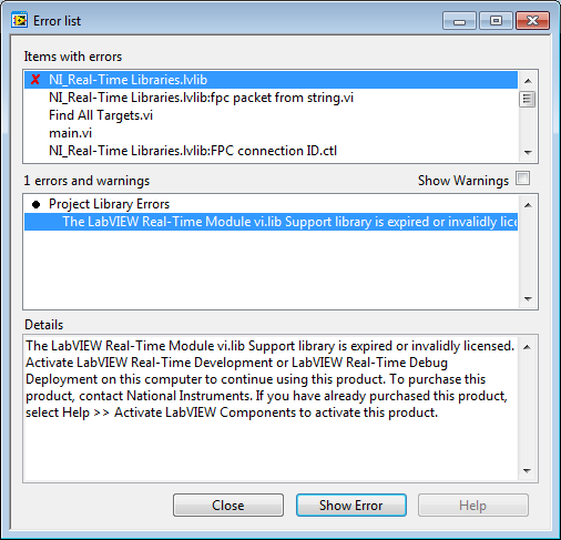

1) Real Time Licensing Issue
I made use of some Real Time Target System Replication functions to create a NI Distributed IO Sniffer.
That work fine in the Standard Run Time.
Using the Enhanced DSC Run Time broke my build, with LabVIEW complaining of Licensing issues:

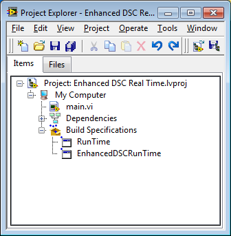

Attached is a project to illustrate this point.
It includes two builds, each configured for a different Run Time.

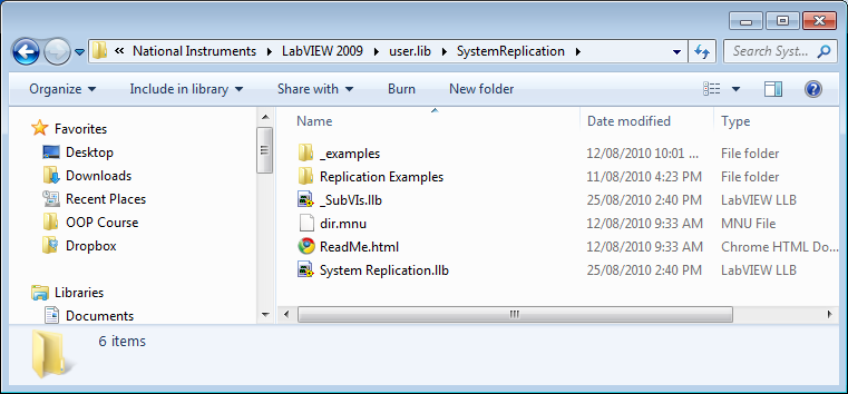

The only dependency is the System Replication Toolkit.
I have included a repack of it in the attached ZIP file to install using VIPM or you can download it and stick it in User.Lib to test:
