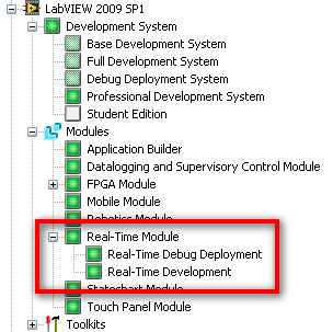

While I'm not familiar with what hardware you are deploying your RT code to, all NI Real-Time Targets include a deployment license in the hardware, as seen in the Tutorial: Deployment and Debug Licenses for NI Software
The only reason I brought that up was because it was listed as one of the potential causes of some of the errors that you were seeing.  I think the best piece of information form your PC would be the status of your Real-Time licenses in NI License Manager.  Are both the development and deployment licenses activated?
Also, regarding the run-time menu corruption, you could try backing up the LabVIEW.ini file, moving it to another location temporarily, and seeing if that changes any obscure configuration that could be causing the issue.  Otherwise, if a repair didn't do the trick then a reinstall may be your best bet at this point.
- Greg J
Hi Greg
This thread is about compile issues using the Enhanced DSC Run Time, therefore my target is a standard PC, not a Real-Time target.
I just want to make use of a function I found in a NI Library online to sniff out NI Targets on the network in my PC application.
I checked my NI Licence Manager - I don't have a Debug Deployment licence only a Development licence.
However, the License issue only killed the build in the Enhanced DSC Run Time - not the Standard LabVIEW Run Time.
