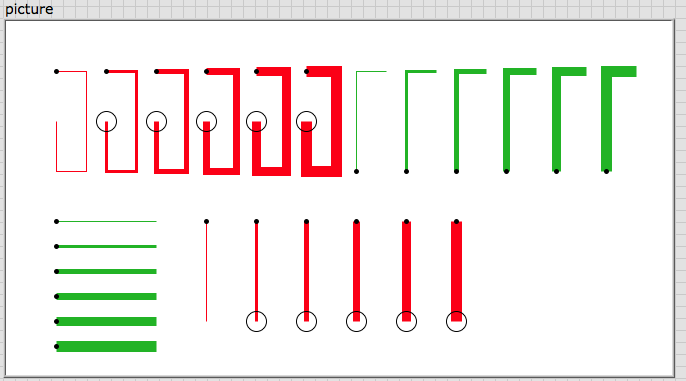

I have a little problem drawing multiple lines that from me looks like a bug.
When I use "Draw Multiple Lines" with whith grater than 1, at the end of last vertical segment some anomalous pixels appear.
The same problem appears also drawing a single vertical segment (two points).
If the last segment for a multiple line is horizzontal, the subVI "Draw Multiple Lines" works ok.
Is it a known bug?
I've attached a simple example to better explain the found problem.
When you launch the VI, some lines with differents widths are drawn; the little black filled circles are the start point of lines, big circles show bad pixels.

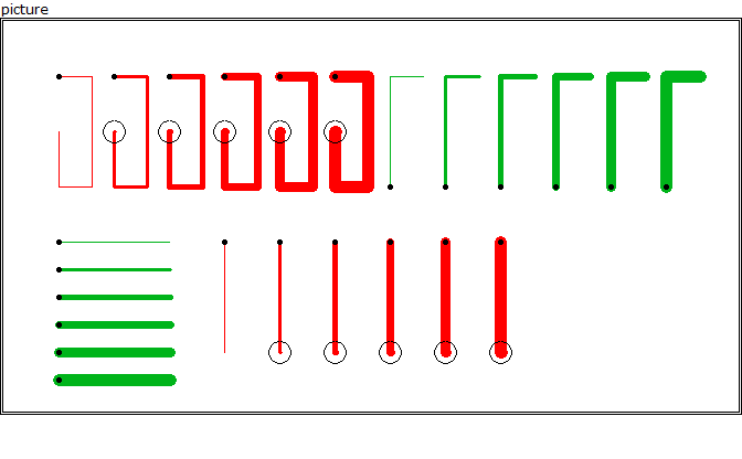

This may be a video driver effect. I do not see anything like that on my Mac. Note that the thick lines are rectangular with square ends and no offsets.
It seems that you may be doing some unnecessary data manipulations.  You add one scalar to one element of a cluster and then add that cluster to the entire array.  Following that you index out the same array elements on every iteration. Why not move the array index operations outside the loop since they never change and add the scalars inside the loop?

Hi Lynn,
the picture you've posted is much better than mine. Also circles are better.
My picture is made with a PC win7 1280x1024 resolution. Your Mac could have a better resolution...
Surely the result that you got exactly what I expected.
So, just to do a verify, I gently ask to other  windows users if they found the same problem.

Yes.  I got the same problem on my Win7.
This is a Line End issue.  You can define Round, Flat, etc. in Windows API.
LabVIEW doesn't expose that option to us.
Picture control is tooooo old.
