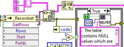

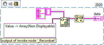

Actually the error occurs in the subVI "DB Tools Fetch Table Data.vi". The subVI is part of the database connectivity toolkit and is located in "...\National Instruments\LabVIEW 2020\vi.lib\addons\database\Auxilliary.llb\DB Tools Fetch Table Data.vi". I found this subVI via the LabVIEW example finder where I modified the example "C:\Program Files (x86)\National Instruments\LabVIEW 2020\examples\database\Read All Data.vi",
Within "DB Tools Fetch Table Data.vi" it is the function "Database Variant to Data" where the conversion from the database variant from output 'GetRows' of invoke node '_Recordset' actually occurs:
I'll try to post a code snippet later with a stripped down example of my code, including the problematic data.

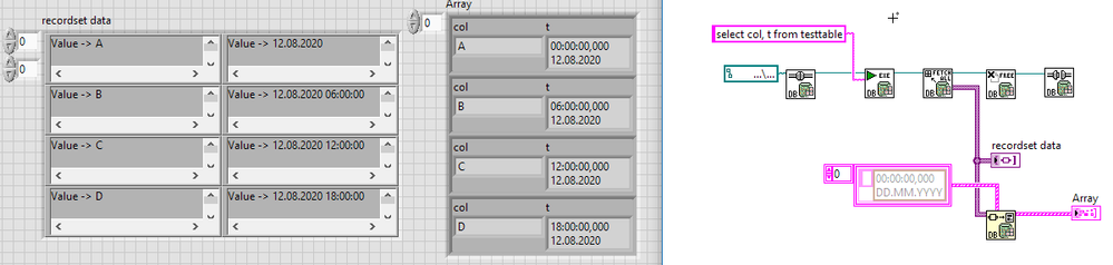

OK, here's the code snippet:
The block diagram constant variant was copy-pasted from my VI.
