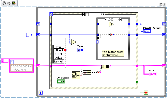

You could also include some logic in the event structure to effectively filter out repeated events for a control if they occur within some specific amount of time. There are valid instances when the consumer should have teh control over when things are enabled or disabled. l agree that there are some extremely poor examples and templates. There is an effort to cleanup the examples (some of which have not been touched in over 10 years). At the same time you can't simply state that due to a potential for a bug one should never allow the consumer to control the state of controls/indicators.
The idea with filtering out repeated events is interesting but sounds complicated to me. Do you have any sample code? So why not just disable controls like "start" or "stop" immediately in the event case? This will prevent enqueuing them twice and breaking the program. Then the consumer loop can still decide what to do with the controls. I never said that it should not touch the controls. I don't speak about old examples, I mean the latest LabVIEW 2012 and the latest courses and exam preparation examples...
Here is a basic example.
Note: The event structure lost track of the ewvent cases when I made this into a snippet. The event above is for the OK Button value change. This code is correct in the development environment.
