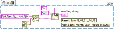

Accepted by topic author JoshX10
Change d, m,y as needed.

what does "%s" means when you use format into string?
(3,165 Views)
It's the placeholder for a string.
But Bonkerz example is a little bit of a Rube Goldberg because the Format into string function will take the timestamp direction when you use the timestamp format code.
