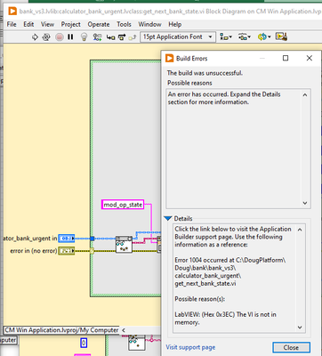

Build error: LabVIEW: (Hex 0x3EC) The VI is not in memory.
I'm getting this error when building. The application runs without any issue in the development environment, and as can be seen in the image below, the VI in question is clearly in memory. My guess is this has to do with the VIM that the VI in question is calling. The previous build attempt failed on the same error for a different VI that also calls this VIM. I've now replaced the VIM with two VIs and trying build again. Any other suggestions?

Removing the VIM fixed that issue, but now fails for the same reason on another VI, also that references a VIM. Trying a mass compile at the moment, but looks like I may need to resort to getting rid of all (or at least more) of my VIM.
