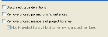

Hello AOrtin,
Another possible workaround for this issue is to use the additional exclusions section of Application builder.  Uncheck all of the items on this category as shown below.
Also, are you getting the exact same error as described above?  There were two bug fixes in LabVIEW 8.5 for Error 1502 when building EXEs but you mentioned that you are already using LabVIEW 8.5.
