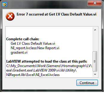

When I remove "build as LV 8.X" and call report functions appear that message:
But then set  "build as LV 8.X" all work fine.

I can't this apply, on compile error.
 But my error is only on labview2009 x64, on x32 all ok without "build 8.x".
Message 53 of 71
(3,094 Views)

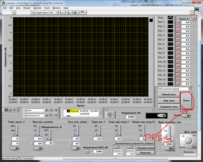

The error appear then press button only in x64 exe without "build as LV 8.X".
The project in attachments.

It might be related to this: http://www.ni.com/pdf/manuals/371780e.pdf#page=46
To clarify, you're getting the error at runtime, but the build is successful?
Yes.

What is your operating system and service pack level? You have both 32 and 64 bit LabVIEW installed on that machine? Or are you testing on multiple machines?
Jeff | LabVIEW Software Engineer
Win7 x64. I have both 32 and 64 labview2009. The 64 bit exe was tested only my machines with win7 x64. The 32 bit exe was tested on Win7 x64 and WinXP x32. The 32 bit exe work fine.
