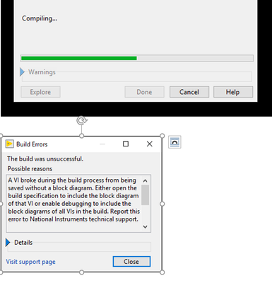

After clearing the compiled object cache, the build got past initializing quicker, but then got stuck on compiling and eventually failed with errors.  Then I ran a mass compile and it resolved everything.  I'm not sure if mass compile did it alone or a combo of the three, but it is back to normal now and I don't have to re-install so I'm happy. 
