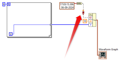

Build waveform Input parameter input t0 should be timestamp. but some example I saw numeric constant. is it possible
Build waveform Input parameter input t0 should be timestamp. but some example I saw numeric constant. is it possible?

Still getting error !

OK, Finally I am at a computer and it seems you are right. For some reason, modern waveforms don't accept DBL for some unknown reason.
There are two items to consider:
(A) I typically use the "legacy waveform", which is just a cluster of t0, dt, and data that existed before the introduction of the waveform datatype. Graphs understand it and will adjust the x axis scaling accordingly.  I like it because it also accepts 2D arrays as data, for multiple plots.
(B) The special timestamp datatype might have been introduced later the waveform datatype, so very old code might still have a DBL as dt. I am really not sure about the details anymore, just guessing here. Seems like you just need to convert as follows:
