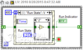

After further research I have managed to implement a VI which is able to toggle a single LED into three states: ON, OFF and flashing. I have included the code for interest and would gratefully receive any constructive feedback. My next task is to implement this SubVI into a stopwatch application.
Many thanks once again.
(4,454 Views)
Accepted by topic author HIRF
More better?  Only one loop, immediate response to shutdown, no Value property nodes...
Jim
