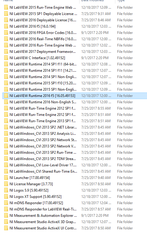

I think product cache is probably the correct folder. It is looking for the installers, not what is installed. You should be able to download the LV 2017 runtime and device drivers and point to them as the installation media. (after any necessary unzipping).

I think the .cab file has most of the data, but you probably need everything. Here is a glimpse at some of the stuff in my product cache folder:
