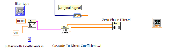

HI Thank you for your quick response.
I should have stated the main problem is the phase shift. I do not want this to happen. I do not see any functions that could let me to compensate for this phase shift. Could you advise me again

You might have to educate me on this "no phase shift".
 Firstly, most analog and digital filters introduce some phase shift.
Now if you want to implement constant or linear phase shift, then you might be talking of FIR filter. Like a symmetric FIR filter might be a good idea
Your design wants butterworth which is IIR, which generally have more complex phase shift.
Perhaps if you can tell me the theory behind implementing a "no phase shift" using IIR, then I might be able to chip in.

Hi .I have realize i need to include a zero phase filter VI after my Butterworth filter. Let me try this first . If it succeed, I would close this thread.Smiley Very Happy
Message 6 of 9
(17,059 Views)
Accepted by topic author pengxin
 Solved!!! Thank you ADE77
