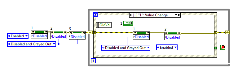

I take it back. Event structure is just what you need:
(3,759 Views)
Excellent, this is exactly what I'm looking for.  Thanks!
