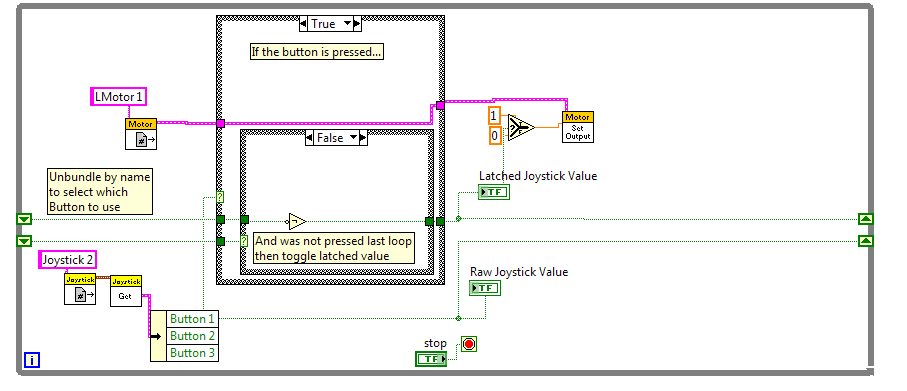

@Arkacaro wrote:
I have been removing things/adding things as you've said before, just that I don't always update that I exactly did that.
Is this more so what you mean?
The "After the nested structures" I'm assuming is after the case structures, correct?
I set the value based on the value of a Latched Joystick Value, I think.
And this VI is running under Teleop, and the Motor and Joystick have been identified in the Begin vi, so I'm assuming it should work this way?
Yes that looks to me like it should work that way.
Alright, i'l try this out tomorrow and see what I get with it, thanks! I'l most likely ask some more questions after that, though.

Well, I figured it out,  I only found it possible to do in one way.
I'l attach a copy of the solution and have a 3rd party hoster for it, for anybody who wants the solution.
The VI has some extra solenoid stuff and buttons. Where the Button 2 goes into the shift registers is where you toggle from a button, the output to the motor is the toggled output. It works perfectly for me, but make sure the wait time
is 100+.
