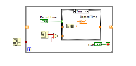

In order to show multiple times, you'll need to change your elapsed time indicator to an array. You can store this array in a shift register. If you press record time, put your new time first so it is at the top of your array. You already have the while loop, you just need to add the shift registers, build array, and case structure.

Increase the array in the vertical direction, you can then use a vertical scroll bar. Notice how I never set the array size, I just keep appending elements to beginning of it, so you don't need to do any guessing.
If you're talking about the array indicator, it is no different than a listbox. A listbox has finite size. If you want, you can change the number of elements in the array using a property node, but the way I have shown you will put the most recent time at the top.

Ahh, perfect! I had to decrease the array to a 1x1 and then re-expand it for the vertical scrollbar to become an option.
