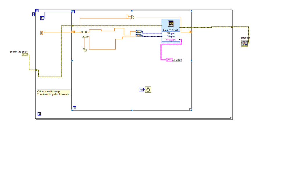

I have a program where have two for loops nested. In the inner for loop I collect data and plot it immediately. When the iterations of the inner loop have ended and a new iteration of the outer loop begins. I aim to change the colour of the plot so that I can know the difference.

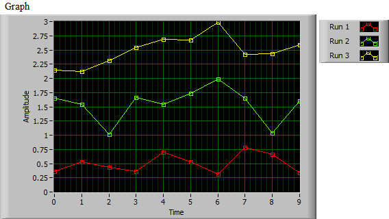

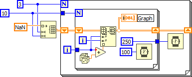

You are using the express VI set to not clear data between calls, so it is more like a chart.
I assume you want a graph with three plots of 10 points each, so initialize an array with this size filled with NaN and replace values as you go.
Since your x values are equally spaced, you don't need an xy graph.
See if this can give you some ideas....

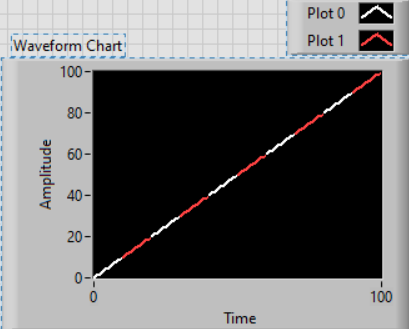

Well, I went with a Chart (instead of a Graph) because I wanted to plot a single line (I chose the line Y = X, where X goes from 0 to 99 (100 points).  I generate 10 points a second, so you can watch the line evolve.  Here's the result:
So how did I do this?  I used a For Loop to generate 100 points.  I plotted them 10 at a time in a Cluster of 2 Dbls, alternating data points and NaN every 10 points.

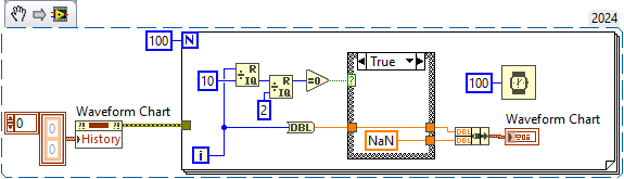

Here's the simple code:

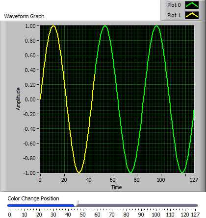

Yes, there are plenty of similar solutions, e.g. here:
An example switching color based on Y value is here:

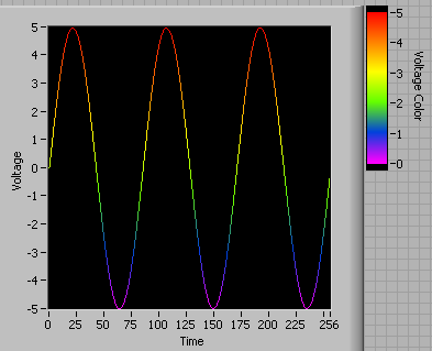

For full color control and intensity graph (or chart if desired) gives access to any color (example).
