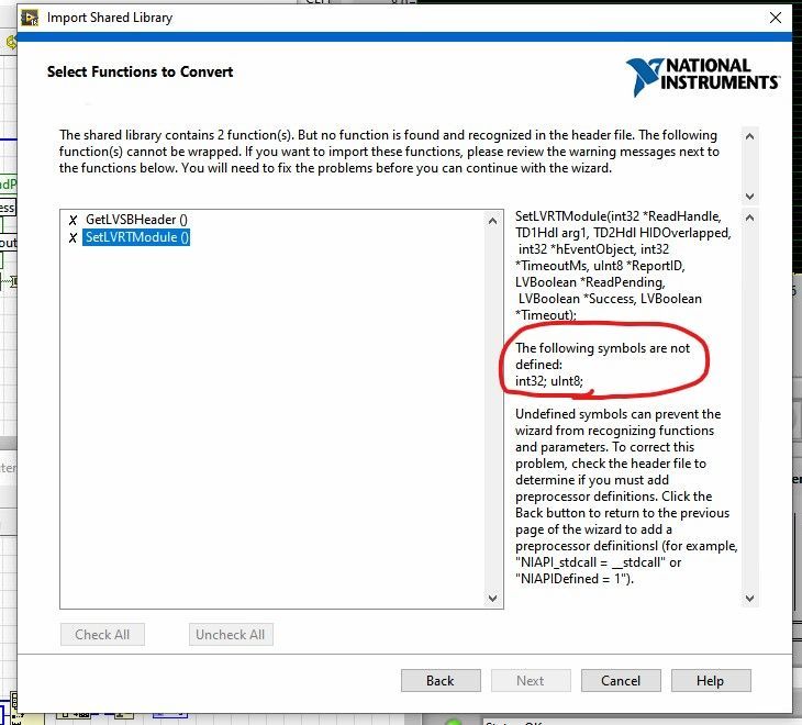

With all this I figured I needed to make one change at a time and the first thing I believe that should be possible is to replace the CIN with a CLFN.  Based on my understanding of the CIN process, a DLL is first built and then an additional process is performed to create a LSB file.  As the CLFN directly uses a DLL my assumption is that I should be able to use the DLL previously created as part of the CIN process with a CLFN.  If my assumption is correct, then I am missing something in how to configure the CLFN as I am unable to get this to work.
I have tired manually configuring the CLFN parameters in many ways and none of them worked.  I also tried to create a header file so that I could use the Import Shared Library tool but there I am running into an issue with 2 undefined symbols which I am not able to figure out how to resolve.
There appears to be a difference in how the function is called with a CIN verses a CLFN.  In the C code, I can see that a structure has been defined for 2 inputs.  It is for an array of data where the structure includes the size and the data.  In the CIN call, only an array of data is passed in.  Is the structure something that the LSB is doing before interfacing to the DLL?  I question this because the structure is the exact some format which is called out in the Using External Code in LabVIEW manual when working with arrays.  In some examples of CLFNs I have seen where the array data and array size is passed as separate elements but I am not sure why this is done and if/when it is required.
As you can see, I have been working on this for a bit of time now and feel that I am going in circles.  I would appreciate anyone that may be able to provide some assistance or additional incite on this.

You can not use the CIN code unchanged. You need to tell the C compiler which function it needs to export. In the past that was not neccessary since the CINRun function was not really exported. Instead a CINEntry or similar function was exported that branched out into the various CINLoad, CINInit, CINUnload, CINSave and CINRun functions depending on a seperate parameter passed to it. LabVIEW called all these functions at various times during loading and unloading of the VI and the CINRun function whenever the CIN was executed.
So you need to make sure the C compiler exports this function. In very old times you needed an according .def file for that, that defined all exported symbols but nowadays you can simply use __declspec(dllexport) in front of the function declaration.
__declspec(dllexport) MgErr CINRun(int32 *ReadHandle, TD1Hdl arg1, TD2Hdl HIDOverlapped,
	int32 *hEventObject, int32 *TimeoutMs, uInt8 *ReportID, LVBoolean *ReadPending,
	LVBoolean *Success, LVBoolean *Timeout);
In this way the function will be available in the LabVIEW Call Library Node for selection. However when recompiling this you will run into 64-bit problems. The ReadHandle is used as a Windows HANDLE and that is a 32-bit value in 32-bit LabVIEW and a 64-bit value in 64-bit LabVIEW. So it would be better to change the datatype accordingly to be a HANDLE. Same for the hEventObject. And in the LabVIEW you need to make these two values Pointer Sized Integers (and passed as Pointer to Value of you keep the pointer operator (*) in the declaration).

@DavidWilt wrote:
Will this take care of the issue with the import Shared Library tool also or will I still need to define something in the Preprocessor Definitions to define the missing symbols?  I assume I will still need to address the missing symbols.  I saw you previously mention adding the Windows SDK include paths to address this but I am not able to find this path on my system.  I installed a Windows SDK from here in order to be able to compile the DLL but I do not find the include folder on my system.
It's going to be a single function to import!!
Forget the Import Library Wizard for a moment and simply configure the Call Library Node manually yourself. That's a lot faster than trying to get the Import Library Wizard to understand your header file (that you haven't really).
The Import Library Wizard is NOT a magician. It can not create code that is going to be valid without someone going over the result and checking that everything is really as it should. The C header file syntax is notoriously inadequate to document all requirements for the caller, much of it has to be taken care of by the C programmer. But it is all the Import Library Wizard has to work on. It can not read the hopefully available API documentation of a library to understand what a specific parameter really means and how it may or may not rely to some other parameters such as the size of a buffer that is passed in. That is something the programmer needs to know and take care of after having read the API documentation several times and quite often written some test programs to test his or her understanding of that documentation. If you can't do the Call Library Node configuration yourself in the first place, you can't verify the created code from the Import Library Wizard to be correct either and trying to execute the Import Library Wizard created code without such a verification is just plain Russian Roulette sooner or later. And I'm here not so much worried about crashes that happen while you are testing your work. Memory buffer overruns can go on for a long time undetected. In the best case they crash immediately, often they will only crash your program at some other point when some function tries to access the corrupted memory, and it is always a security concern that could be exploited too.
For instance the two TDxHdl parameters directly map to LabVIEW array handles. While it would not really be necessary anymore to do that when using a Call Library Node (you could not pass C pointers to a CIN), the Import Library Wizard will have a hard time to recognize that these are actually LabVIEW handles. It may be able to recognize it if you change the type definition to be a LStrHandle, as that is an officially documented LabVIEW C datatype but I'm not sure the Import Library Wizard was built to recognize LabVIEW compatible variable types as that was not its main concern. Why would anyone use it to import DLLs that were specifically written for LabVIEW?
A LStrHandle has in fact the same memory structure, but if you make this change it will require you to also change part of the C code that accesses the interna of those arrays as the elements in a LStrHandle are somewhat named differently.
Principally you could make the HIDOverlapped parameter simply a char* pointer and pass it directly to the ReadFile() function and configure the Call Library Node parameter to be an Array of unsigned 8-bit integers passed as C array Pointer, by value.
The arg1 parameter, which is an awful name for a parameter, should be left as a handle, if you do not want to change the C code any more. And in LabVIEW you configure it as a LabVIEW String or Array of unsigned 8-bit integers, passed as LabVIEW handle, and as Value.
It's memory handling is however suboptimal in the C code. The Read File() function does not necessarily return as much data as is required through its 3rd parameter but only as much as it returns in the 4th parameter in the BytesRead variable. However that variable is never used or passed back to the caller in any way. In addition the ReadFile() function is told to copy the data into a global variable in the C code of size 4096 bytes but with the size of the passed in array handle. If you ever intend to read more than those 4096 bytes and preallocate that much of a buffer in your LabVIEW diagram and pass it into this function, you will corrupt memory. All in all it is pretty terrible code!!
And wherever your program creates the file handle and the event handle, make sure those parameters are also changed to be pointer sized integers in those Call Library Nodes. Otherwise the code will need to be revisited again when you test it on 64-bit LabVIEW. Also, are you sure you don't have another CIN somewhere that opens the file handle and creates the event handle as well as allocating the LPOVERLAPPED structure, in which the event handle has to be assigned to one of the structure elements?
