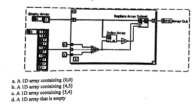

This is a question that I encountred in my CLAD Exam , I'm sorry for the quality of the question , but as far as I can see , there is an array full with boolean constant , I think the output will be 6,4 but it does not appear in the options

Replace Array Subset will never resize the input array. So the empty array remains empty.
LabVIEW help writes:
Replace Array Subset does not affect the original input array. This function crops any subarray that is too large to fit as a column, row, or page in the input array. If any index is negative or larger than the corresponding dimension in n-dimension array the function has no effect.

Thank you very much , I didn't think about it !
