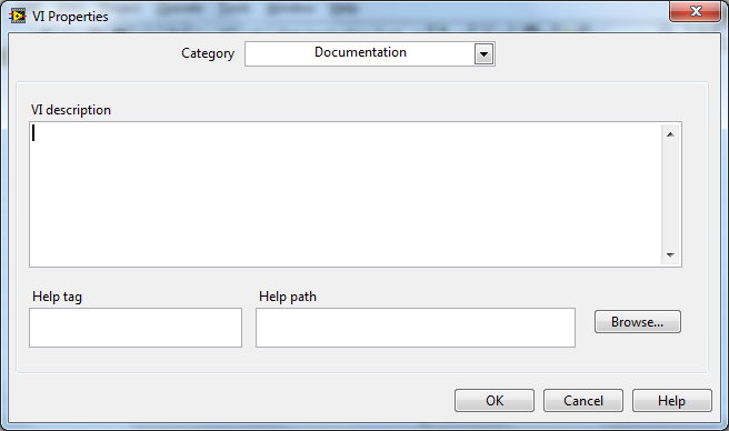

Just to clarify, when you talk about the VI documentation, do you mean that I should put comments on my main vi block diagram to describe the subVI's?  Or are you referring to the comments on the BD of the subVI's?  I did that when developing the application (created empty VIs with the error clusters and case structure, and I wrote comments in the subVI as a note to myself what the subVI was supposed to do).  Then when I went back and coded the subVI, I removed the notes.
I'm thinking I should leave the notes in, or revise them to be more appropriate for comments.
Message 9 of 18
(6,659 Views)
NO NO NO
Comments in the Code explain How what you did did what you did.  USE them
VI documentation is a VI property (that you seam unaware of)  and shows up in the context help floater with Cntrl + H on.
File> VI Properties> Documentation. Ctrl+I> Documentation)
It is the first thing to do---- without adding something to this property of each vi you may not earn a shirt
