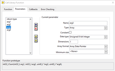

The return type is MqttClient which I think it's a int32 reference but I cannot find out what type it is. My CLFN prototype looks like this:
I cannot get this to work in any way, shape or form.
I appreciate any idea.

The return value is an object pointer so as far as LabVIEW is concerned you would want to configure this as pointer sized integer.
The nastier part is your string variable though. In .Net a string is a 16-bit Unicode string, but LabVIEW uses 8-bit ANSI strings.
You would either have to configure the parameter in LabVIEW as an Array of 16-bit Integers and call some function to convert the 8-bit LabVIEW string into a 16-bit Unicode string for instance by calling the function in the ni_lib_unicode VI package that you can download and install with the VIPM.
The other variant is to declare the function with a byte array input instead of string and convert that into a .Net string through the according string encoding facility.

Thank you for your reply.
I made some adjustments from your post but now I face another problem. In C# only the first element from both arrays reach the function and I do not know why.
So for example: 10.10.10.10 -> [49,49,49,49,49,....] if I use a popup in C# I will see a 1 element array and only a single 49 reaches the function.

I was actually afraid of that. On further consideration the .Net code has no way of knowing how long the byte array is that is passed in, so the interop translation probably just assumes one element when the pointer seems valid. Maybe it would work if you changed the syntax to something like this:
static MqttClient Connect(byte IpAdress[50], int Port, byte clientID[50])
and then made sure that you configure the Minimum length in the Call Library Node to these lengths. Or there might be a .Net Interop annotation of some kind that you can append to the parameter specification, to tell it that the array length is determined by a Zero byte in the stream?
https://docs.microsoft.com/en-us/dotnet/framework/interop/default-marshaling-for-arrays says:
When marshaling arrays from unmanaged code to managed code, the marshaler checks the MarshalAsAttribute associated with the parameter to determine the array size. If the array size is not specified, only one element is marshaled.
This would indicate that you might have to do something like this instead:
[MarshalAs(UnmanagedType.LPArray, SizeParamIndex=1)] byte IpAdress[], int addressLen, int Port,
[MarshalAs(UnmanagedType.LPArray, SizeParamIndex=4)] byte clientID[], int clientLen)
