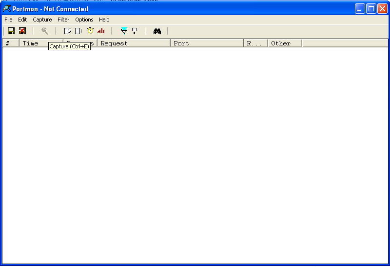

I seem to be having an issue with PortMon though, the "capture" icon is greyed out so I can't select any ports to monitor.
I found a few other pieces of software such as Serial Port Monitor, Serial Mon, Serial Port Monitor, etc. but they all seem to either cost money or they are actively controlling the COM port, rather than passively sniffing. I'll keep rooting around, this method does show some hope. Thanks for all the help so far.

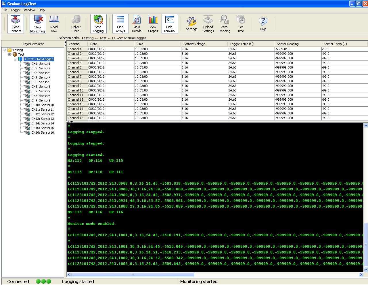

So looking into the actual LogView software that Geokon uses, it looks like they have a terminal that you can see what is going on. Here's a snapshot that shows some data coming in
Every one of those lines that start with LC1123101742 is an array of data at a given time.
I'm gonna root around a little bit and see if I can figure out if I can directly access the data from this terminal somehow.
