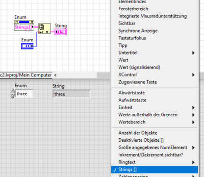

Maybe you mean something like this? You want to get the TEXT (String) from your ENUM constant? But my example is not with an ENUM constant.
regards
