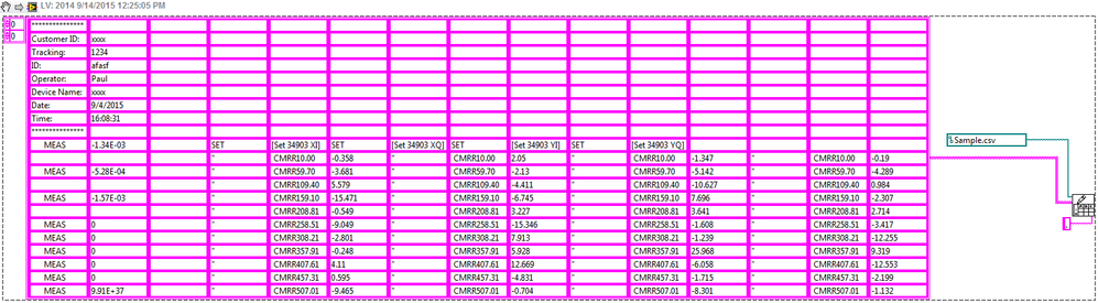

To clarify regarding the 2D array, if you generated an array like below and wrote it to file, it would come out the way you want.
