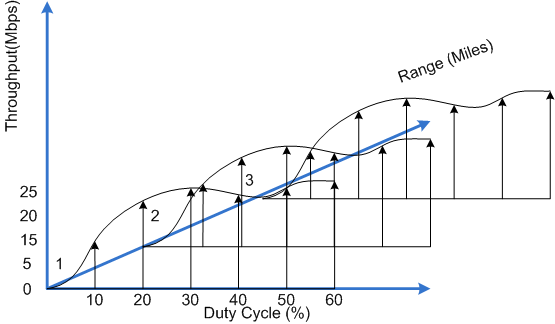

I've been on the forum looking for a good 3D graph example and found several, mostly CWGrah3D.  But no matter how I try to wire my arrays into the graph I can't get my data to look as expected.  I decided to make a drawing and hopefully someone could help out.  I don't need to display arrows (there are there to make the drawing more understandable...I hope) but a 2D curve or surface plot would be helpful to visualize areas that have low throughput, possibly using the color intensity examples I've seen.

I'd us a parametric plot if you want a surface.
When working with paramteric plots you specify a set of points that are described by a triplet of X,Y,Z.
There is seperate array for the X values Y values and Z.
It wants a 2-d array so it knows which points to connect. Adjacent point will be connected.
If you just want three line, then use a unique plot number for each trace.
Ben
