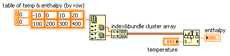

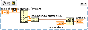

Hi Snehal,
as a CLAD you should know all this:
As the snippet tool of LV2013 mangles the blockdiagram (by replacing the array constant by a control and a scalar constant) I attach a real picture too:
The snippets made by the code capture tool don't have these issues, in case this really bothers you. You can install the CCT from VIPM. Just saying.
