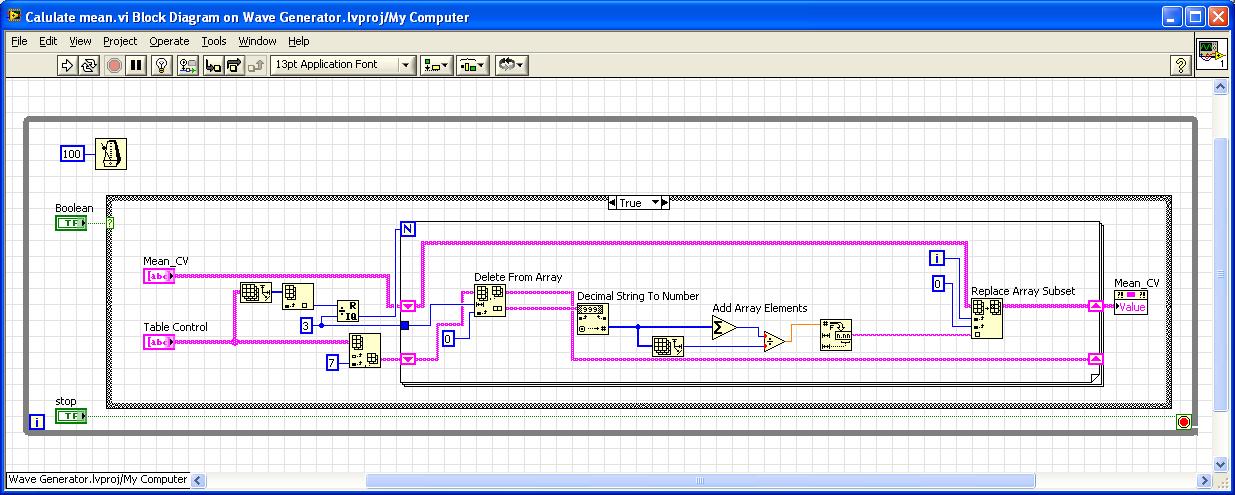

I have a table in which i am getting some readings. I want to calculate the average of the cells which are shown in the image. (Please see the attached image)

U have used the solution in your code only,
U can get the three values as shown in the fig attached,get their mean and in the same way write it in the table with the help of row and column.

Accepted by topic author kaush
Jim
Message 5 of 8
(5,415 Views)
Find the solution.

Hi jcarmody
         Nice solution without loop and shift register,great thinking.
