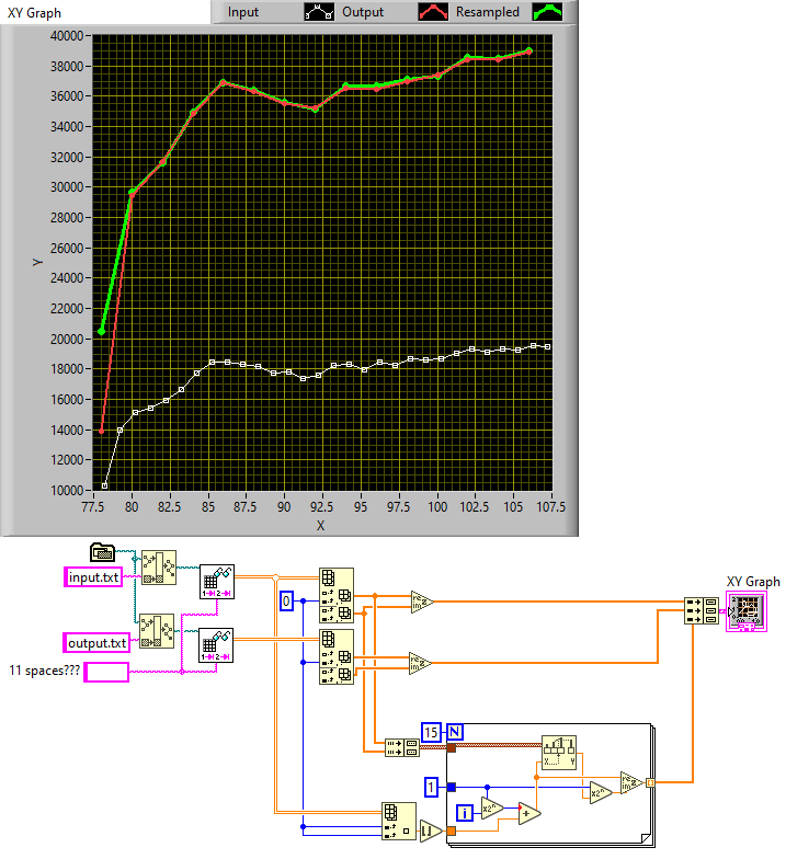

Here's my "best effort" attempt at your code.
But I don't get exactly the same values as yours for the first case, and not at all for the most recent input/output pair.
The 11 spaces is a little problematic reading the file - it seems a bit arbitrary (although of course it can be handled, it's a little strange).
Is it some sort of tab -> space issue with some editor?
Edit: looking at your recently uploaded .C file I think probably I'll get the same results as you for the first page if I change the "B" value - in your original code you gave 1.0006, but in your .c file you have 1.00027. I'm guessing that might be enough (at least in the first case).
Message 12 of 18
(2,426 Views)
Yes, looks mostly like some kind of resampling assuming a slight nonlinearity in the x-scale.
Even if I assume linear scales and double the Y, I get pretty close. (maybe within noise!?)
So all you probably need to add are a few nonlinear tweaks based on your values.
Message 13 of 18
(2,421 Views)

Actually, there is no constant algorithm for this calculation.
What I want to do is make a re-binning process for the energy axes (column 1), to compress it from around 1 keV interval to be 2 keV or more interval. the goal of this process is to increase the results statics because the measurement time is too short and with the current conditions the noise of the spectrum will be so high.
this is my idea and I already use it before in my work.
but I get the general ideas from the attached paper. you will find it clear on page 2.
for your information, I modified this idea to be the code that I shared with you.
about the distances between the column, it is not so important. I can control it easy or change it to "," or deny interval. or we can change the input file to be .xls file in 2 columns.
Message 15 of 18
(2,376 Views)

Accepted by topic author Khallod
Here's mine as LabVIEW 2018.
altenbach's appears to have been saved back to 2015, so you should have no problem with that if you want to use/test it.
Message 17 of 18
(2,364 Views)
