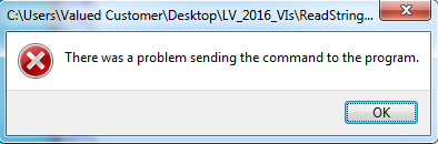

If we log into a different account, e.g. "Valued Customer", that has an Administrator account type, we can get it to work if we set the LabVIEW.exe executable to "always run as Administrator," except that we get the following error if we double-click a vi:
If we open the VI from LabVIEW, then we don't get that error.

Since Windows 7 you have some privileged operations that even Admin account rights are not enough to perform, such as running any installation program. You need to be explicitly elevated. If you are logged in as Admin, you get typically an extra dialog prompt where you have to acknowledge that you want to do this operation. As non Admin user you get a login dialog that requires the Admin credentials to login as Admin and get into elevated mode at the same time. Launching a program as Admin also normally gives you these prompts and starts the program in elevated mode too.
Something in your application seems to require this elevated mode and that is definitely not LabVIEW specific.
