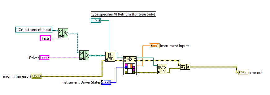

I'm having a hard time with the code below being executed in the UI thread.
I've read the following article:
https://www.winemantech.com/blog/the-ui-thread-root-loop-and-labview-what-you-need-to-know/
It suggests that using the Call by Reference should enable me to run in any thread, but it also mentions that if I use a type specifier the code will run in the UI thread.
Any help on how I could convert the following code to code that can dynamically run a VI in any thread would be greatly appreciated!

I've made an example (LV2014) that replicates my problem.
If I run directly, and interact with the GUI, for example by opening one of the LabVIEW menus, and waiting for a little bit here is what I get. The UI thread is getting in the way of the call extending the time for the vi to return the value.
If I call the same VI directly and interact with the menus it works correctly.
What I saw from the LabVIEW help is
"If you wire a path, LabVIEW waits until the user interface is idle to load the VI from disk. If you wire a name string, LabVIEW does not need to wait until the user interface is idle, as it does not load a VI from disk. LabVIEW will only search in memory for a VI with a specified name. "
I am not wiring a path I'm wiring a string with the VI name.
Hopefully the example will help to understand what I'm struggling with, and what am I doing wrong?

@ Ben,
Thanks I read that thread but I didn't have enough duct tape.
After I've made the example to show the problem I think I figure it out.
The issue is that I'm opening and closing the reference in my DAQ loop.
If I open it Before and Close it After the UI thread won't come into play, as it hangs by Open VI reference no the actual Call by Reference.
Thanks I think I'm sorted!
