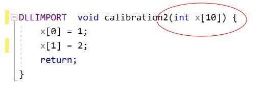

Thank you for responding,
I'm using Intialize Arrary to create an array before going into the first DLL function as you suggested. I create a 1-D array with size of 10. But the outcome seems to be wrong.
fig1 is my DLL function.
fig2 is my Call library function node setting.
fig3 is my LabVIEW outcome.
(5,639 Views)
Change int to int8_t

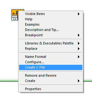

Right click the dll config node, let LabVIEW create the C file for you.

George already told you what you should have done. The main fault (the rest are more beauty mistakes) is that you declare the function to take an array of ints as parameter. An int used to be 16 bit under DOS but that is 30 years ago. It’s since on almost all platforms a 32 bit number. In LabVIEW you however configure the parameter to be an array of bytes (8 bit). The C code does what you told it, it treats the array as int32 values filling in your first number into the first four bytes and the second number into the next 4 bytes. LabVIEW also does what you told it to do, it allocates an array of 10 int32 values but coerces them to an array of 10 8 bit values as you told it in the CLN configuration that the array is supposed to be of 8 bit numbers.
You were lucky that you didn’t attempt to assign a 3rd number to the array because LabVIEW passes in a memory buffer of 10 bytes but your third variable would try to write to byte 9 to 12 and bummmm 💥. Either the CLN returns a 1097 error, which indicates there was some memory corruption or similar going on (but ignoring that error is baaaaaad) or Windows shuts down LabVIEW immediately as it detected that something bad was going on! Either way you are in trouble! It could also be that neither can detect that something went bad, which is the most nasty situation for you. The memory corruption happened anyhow and something went corrupt but you only will find out (sometimes much) later when some unrelated code section crashes on you!
