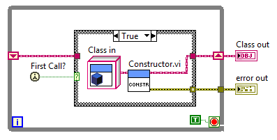

I'd like to use a by-ref class using a DVR that is instantiated when one of a handful of its member functions are first executed and that doesn't require explicitly invoking a constructor on the top-level. This single class reference is then used by all class members from that point onwards (providing their input ref is null/unconnected).
I can create this one-time reference using an FGV, similar to the following, but because the class purposely has no central constructor/ownership I need to dispose of this class when the last VI in LabVIEW's application context has finished executing.
Is there a way of doing this, or maybe even a better way of achieving the same functionality?
I'm envisaging only using this configuration when running the code in the IDE - for complete applications, there would be one central constructor and destructor.
FGV example:
