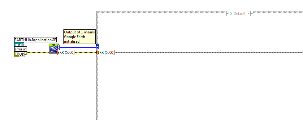

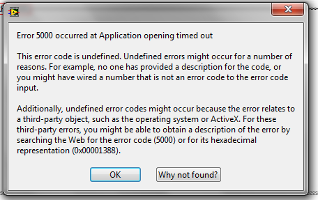

Dear Emily
Hello. I´m having problems using the Google Earth Activex and Labview, and I think is because the 64 bits version of Windows and the Google Earth. I attach my error messages. Please could you give me some solution to use the Google Earth Activex for 64 bits system?
I´m using LV2013 and Google Earth version 7.1.5.1557
Please answer me.
Thanks.

Hi Fertronic79,
Under steps to execute and system requirements on that document, it mentions that Google Earth 4.3 needs to be installed. Do you have this specific version installed? It may have issues with later versions of Google Earth.
JD B.

Dear JD
Thanks for your answer. Yes, I have installed the Google Earth version 4.3 but in Windows 7 32 bits doesn't work the ActiveX, but if I use the same VI for Windows XP 32 bits works fine. So isn't possible to use in 64 bits systems? I think you should publish the update VIs to use the Goole Earth in 64 bits systems.
Message 5 of 11
(5,504 Views)
I am sorry that you are having trouble getting the example to work. The example on the community page was written by a LabVIEW user and is not an official example created by National Instruments. If you would like support with this VI, you will need to contact the creator. Unfortunately the example was written in 2008 and is most likely no longer supported by the creator.
JD B.
Applications Engineer
