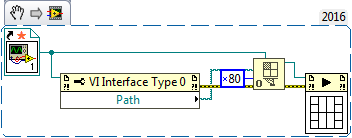

Have you tried the Start Asynchronous Call function?  I stopped using VI Server shortly after Start Asynchronous Call was added to LabVIEW (around 2010, perhaps?).  I urge you to try this:
  1. Drop a Static VI Reference.
  2. Right-click, change to Strictly-Typed, then Browse for Path to the VI you want.  It really helps to give your sub-VIs a recognizable VI Icon (the Icon you see here is the Icon you are using for SUBVI01 -- not very mnemonic.
  3. Drop a Property node, and wire the VI Reference to its input.  Change property to VI Path.
  4. Drop an Open VI Reference.  Wire VI Path to Path from Property Node, connect Error Line to Property Node, and wire (Strict) VI Reference to top "Type Specifier" input.
  5. Right-click the Open VI Reference and select "Help".  Read about the Options input.  You probably want 0x80, "Prepare to Call and Forget".  Wire the Options input appropriately.
  6. Drop a Start Asynchronous Call function, wire the Error Line and the VI Reference lines from the Open VI Reference.  Notice you'll get (part of) the Connector Block of your chosen sub-VI, which you can use to pass values to the sub-VI when you call it with this function.
One tremendous advantage of this scheme is that it works exactly the same whether in Development Mode or built into an executable.  Here's a Snippet to admire (in LabVIEW 2016):

Go with Bob's suggestion.  The only thing I'd like to add is that instead of getting the VI Path I generally get the VI Name.  The Open VI Reference works on VI Names (string) or VI Paths (path).  But if the VI isn't saved then there is no path and it will only work on the VI Name.  Not a big deal in a VI that is saved but for quick VIs I'm testing, I may not have saved the VI to disk yet.
