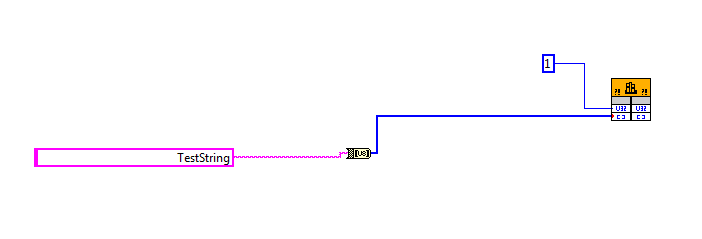

Thus I give one string , and convert the characters to 8 bit unsigned array and LabVIEW code looks as shown as below: (Instead of Array of Strings). The input "1" is number of arguments/strings.
This code runs without error 1097. But my DLL reads the string as random symbols. One example is shown as:
I do not know why my DLL is reading random things from memory. I am pretty sure its expecting pointer to pointer of character, and may be LabVIEW is giving something different.

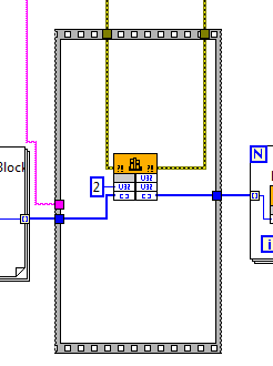

I also tried an array of strings, and used "Adapt to type" in the CLN, but then the output changes from random characters to some number. (Like x5bc087305bc003b5.....

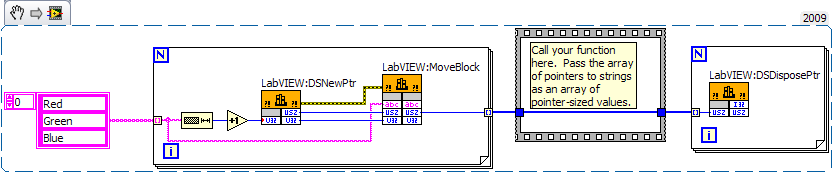

The discussion to which I linked demonstrates exactly this situation.  Here's the code from that post (I'm the one who posted it there, so I'm not copying someone else's work).  This is a "snippet" - you can drag it directly into a block diagram (with some web browsers you may need to drag it to the desktop first, then drag it from there into the VI).

Hi nathand!
the solution works!
Thanks a lot. Now I will spend some time and try and figure out whats happening there, and if I have some questions, I hope I can ask you.

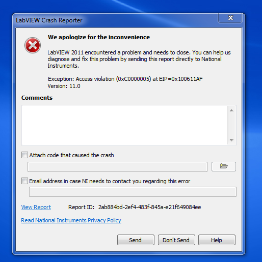

Anyways, sometimes I end up getting the screen below, after succesful execution of the VI. Any ideas why?  I have attached my CLN replacement, in case that could be a source. Thanks.
Message 6 of 9
(5,369 Views)
I don't know anything about that error and your screenshot reveals nothing about the configuration of the library call.  I recommend setting the Error Checking level for your call to the DLL (in the Call Library Function Node setup) to "Maximum" and see if any errors appear.  Is it possible there's an error in DLL and it's doing something it should not do with the memory?

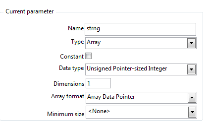

Oh sorry, here is a snapshot of the config, and I am pretty sure there is no problem with that
Anyway I have no access to DLL nor to the people who coded it, so I have no idea how it handles memory.
I will try figuring out the reason for the crash. Mostly the crash occurs when I hit "save".
