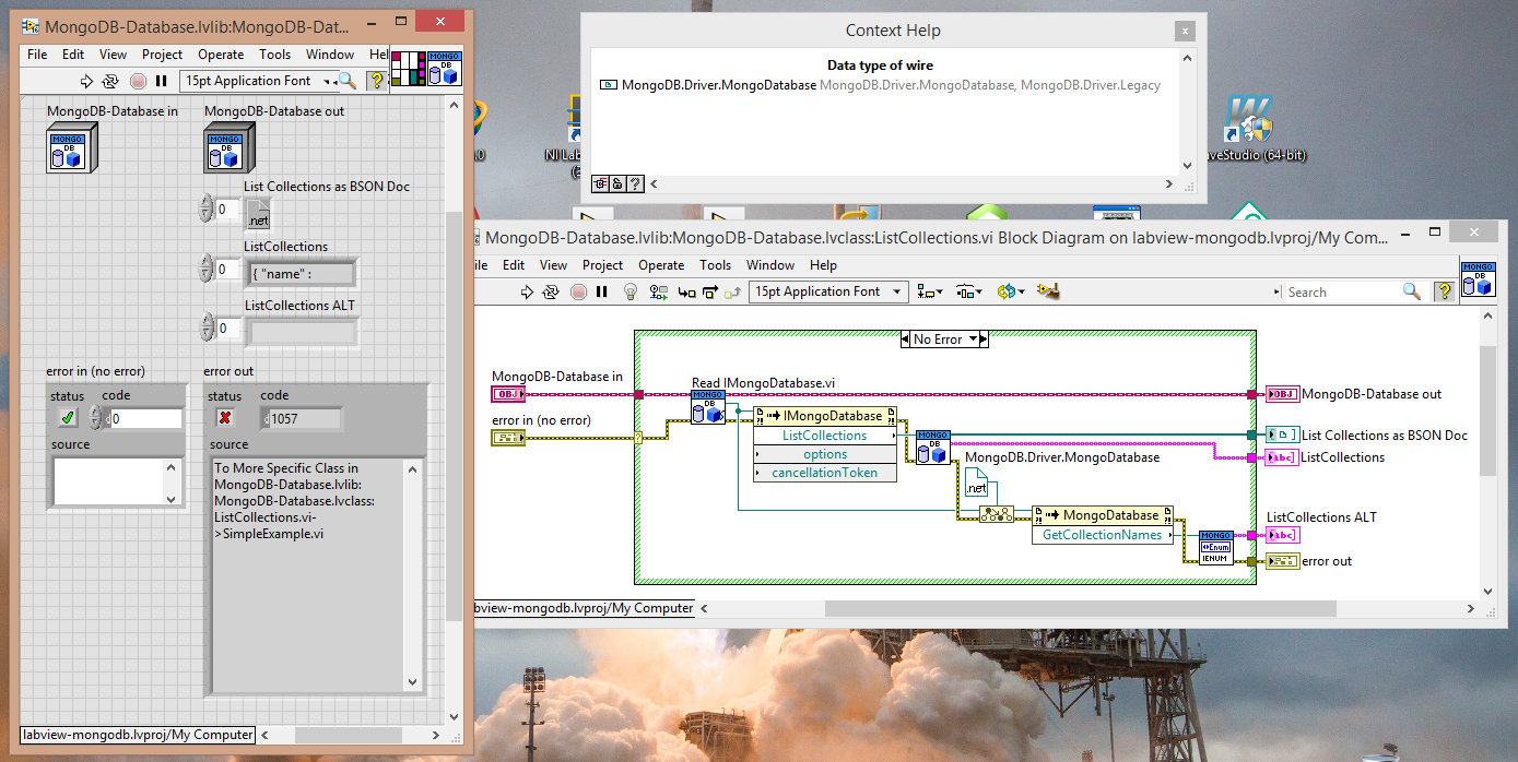

I'm calling the "ListCollections" method (https://mongodb.github.io/mongo-csharp-driver/2.3/apidocs/html/M_MongoDB_Driver_IMongoDatabase_ListC...) with an IMongoDatabase refnum.
This works without any errors, but I have troubles handling the result.
According to the documentation it is an "IAsyncCursor<BsonDocument>", which is aimed at being able to be handled asynchronuously (if there is a tutorial out there how to implement that in LabVIEW, I'm very interested).

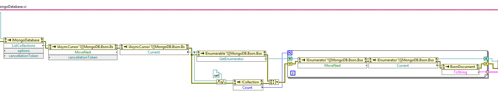

By looking at this tutorial (https://www.codementor.io/pmbanugo/working-with-mongodb-in-net-2-retrieving-mrlbeanm5) I figured out a way in LabVIEW, but it is one example of complicated code due to programming languages interfaces...

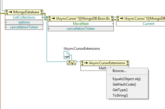

This does not seem like a suitable idea for the long term, and I came across the extension methods for IAsyncCursors (https://mongodb.github.io/mongo-csharp-driver/2.3/apidocs/html/T_MongoDB_Driver_IAsyncCursorExtensio...), which offer methods such as "ToList". Casting the dotNET ref from IAsyncCursor to IAsyncCursorExtensions unfortunately didn't offer me any of those methods... (see following picture).
Is there something I'm missing when using the extension methods?
I found a post from the TestStand forums from 2012 (http://forums.ni.com/t5/forums/v3_1/forumtopicpage/board-id/330/thread-id/36029/page/1) that suggest that extension methods are not available.
Is this also the case for LabVIEW?

First up regarding the enumeration - no, there is no better way in LabVIEW (besides using SubVIs to hide the mess of course). C# has nice syntactic sugar for performing the enumeration but, in the background, the C# compiler actually converts it back into the same thing as what you are doing.

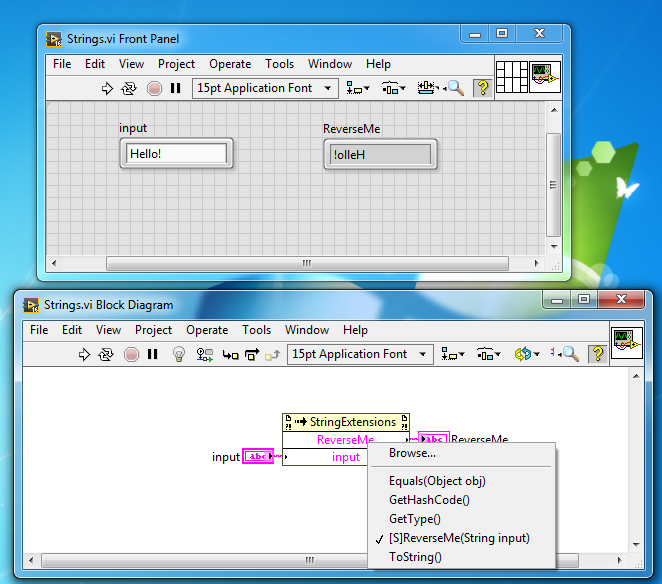

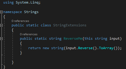

Extension methods in C# are actually just static method calls on static classes with a particular syntax when defining the method - the first input to the static method call is the class instance you want to operate on and defined with "this". The C# language allows a developer to perceive that you have somehow magically added a new method to a class when you use them but this is not the case; they are simply bog standard static method calls in the end and can even be called like any other static method call in LabVIEW (even C# if you wanted to for some reason).
So Extension methods are available to call in LabVIEW but you have to understand the secret sauce behind the magic and call it just like any other static method call. Here's a quick example I whipped up that reverses a given string. You can see that I call the static method directly (the class is static so no need for a constructor) and the extension method is marked as [S] for static:
In case you are curious, here is the basic code for this assembly, see how it follows the requirements for extension methods I described above:

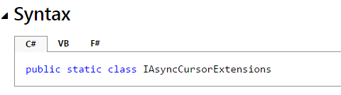

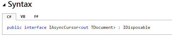

Now, back to your case. Looking at the documentation for IAsyncCursorExtensions, I see that it is a static class (as we would require for a class housing extension methods):
So far, so good. In order to use the methods on this class we need a static object instance. In LabVIEW, we basically don't need to do anything - we just drop down a property or invoke node for the static class to call its properties / methods. Now lets look at the ToList method:

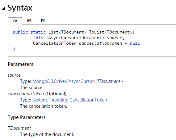

See that this is a static method call. The first parameter is a type designated with a "this" - this is the special definition that makes this an extension method so that the C# syntactic sugar can work however it is just a class instance of the type that this static method operates on.
However there is a wrinkle - note that this is a generic method (rather than a method call on a generic class); you can tell from the "<>" brackets format in front of the method name. LabVIEW is not great with generics in general (you will have noticed that strange '1 style syntax in your nodes) and, in particular, LabVIEW cannot call generic methods on a non-generic class. This is because the type is not defined until run-time and LabVIEW cannot create new open or closed generic types (although you can instantiate generic objects from completely closed types, refer http://digital.ni.com/public.nsf/allkb/DC41DCDA972642CF8625787E00732DDD). This is why you don't see any in the list (every method in that static IAsyncCursorExtensions class is generic, so you only see the methods inherited from the type 'object').
The solution I would suggest for you would be a wrapper class in C#. This would expose the basic functionality you need and also conveniently hide the generic and enumerating portions from your LabVIEW codebase. You would be able to leverage those same C# syntactic sugar constructs in your wrapper assembly but then expose basic calls (using primitive types).

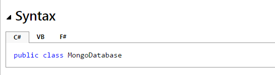

I figured out that there seems to be a specific class "MongoDatabase" (http://mongodb.github.io/mongo-csharp-driver/2.4/apidocs/html/T_MongoDB_Driver_MongoDatabase.htm), which unfortunately resides in the "legacy" driver part...
So I'm assuming that using that driver (which apperas to be simply implementing most methods with BSON type as <TDocument>), is a possible but not future-proof approach.
Is that correct?
And if so, why is casting to more specific of an IMongoDatabase to MongoDatabase not possible?

I don't have the specifics (you would need to dig further) but this is the signature of the MongoDatabase class
 Notice that it does not implement the IMongoDatabase interface (or any other class except object implicitly). So the To More Specific class will not work and LabVIEW rightly points that out.
I'd be guessing but I'd say that the C# MongoDB API has undergone refactoring in the past and, unfortunately, some of the names between the legacy namespaces and the current namespaces are similar which leads to confusion. The course of action I'd recommend is to stick with the current namespaces - the advantage of using a C# wrapper is that LabVIEW will be blissfully unaware of all this and will not change if you make any adjustments to the inner workings of your wrapper.
