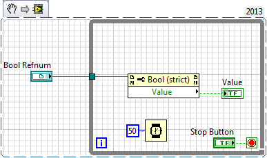

Lets just whip up a little example then shall we?
The subvi you see contains:
Go ahead and run the top vi.  Press OK and watch the value of Value change (up to 20 times per second but that is faster than your eyeball).
Why the difference between this simple example and what you are seeing?
If I had to guess (And, I do since the caller wasn't encluded) I would suspect that you misswired the reference.  With that over-burdened connector pane and no required terminals it would be fairly easy to do.
And thats where you might want to ricght-click the vi and deselect view as icon.
You'll find out that its a lot easier to wire the right terminals that way.  Also, changing the terminals to "Required" for anything that is as important as an exit condition is a good idea.  Perhaps even exit if the reference is null although that should cause an error on the property node.  Did you shut off automatic error handling?.... Nope you didn't so there is a valid reference going into the sub-vi.  But a reference to what? maybe not the button you think.
