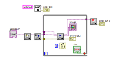

I have a camera connected to a CVS 1495RT via USB cable, and the CVS is connected to my computer using ethernet cable. I am trying to acquire an image using the camera connected to the CVS however only the webcam connected to the camera is recognised in LabVIEW. Is there any way I could acquire images using the camera via LabVIEW?
Below is what I did on LabvIEW where only the webcam is seen as the option:
I know that the camera and the CVS are working with the laptop because everything works well when I use NI Vision Builder-I can acquire image through that. However, I would also like to do it using LabVIEW.
Another alternative question is is there any way I could incorporate my NI Vision Builder with LabVIEW?
