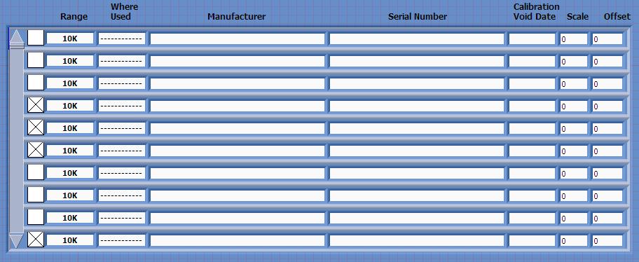

I posted an example that uses an array of clusters to do something similar.
That technique takes some customizing of the controls but requires no coode to implement.
It looks like this

Thank you for the answers,
I prever the solution with the array and the slid from ben.
