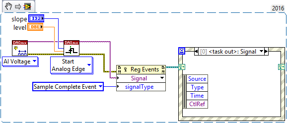

Wiring the DAQmx Task into a 'Register for Events' node (such as is used to create the dynamic events for an Event Structure) allows you to trigger events on certain criteria. However, I'm not sure that you'll be able to do with with a USB-6000. A link describing the idea is here: http://www.ni.com/tutorial/4102/en/
For the analog signal you're describing, you might be able to use an Analog Edge to trigger your acquisition, and just acquire a small number (perhaps 1?) of points, and use the DAQmx Event with 'Sample Complete' to trigger an event structure when the acquisition completes, but I'm not sure how easy it would be to retrigger, and how you'd go about having two edges (or distinguishing them). If you could use two analog inputs, both of those problems would disappear (but you lose an input).

With two inputs, yes, that's what I meant. I agree, not the nicest solution! Regarding retriggering, I'm not certain - it might be that just using 'Start' in the event case (or immediately preceeding/following the sending of your command) would be sufficient to reset it (I don't know).
If you have a TTL signal, you'd have a much easier time. In that case, you should see if your hardware can use the 'Change Detection' event on the DAQmx Event, wiring a Digital Input (rather than Analog Input, as shown in my first reply) and changing the enum constant to 'Change Detection'. This should presumably run every change, and so no extra code would be needed as far as I know to get it to repeat as you want (unless you have far too many max/min cycles, in which case you'd need to work out if you should ignore them!)
