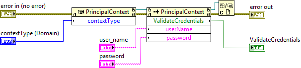

I know this thread is pretty old, but here is an easy way to validate active directory user's credentials (username and password combination). This VI is .NET System.DirectoryServices.AccountManagement (3.5.0.0)
Actually I found the information as PowerShell script here. It should run on Windows 2000 and later.

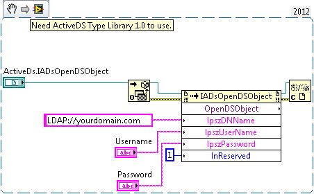

I know that this thread is old, but you can also use the ActiveDS Type Library to authenticate users.

I would bet that OpenDSObject returns an object refnum in the variant. Not closing that as well will result in a memory leak until the application is shutdown. No problem if you only validate once every so often but a total no go for an application that would stay active all the time and validate users repeatedly.

Your probably right. I hadn't considered that for this example. I haven't used the Active DS library in quite some time, and I am sure you can expose other groups, users, computers, etc.
